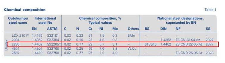

The second generation DSS is represented by 2205 developed by Sweden after the 1970s, and the PREN is 32~39;
The 3rd generation DSS is super duplex stainless steel (SDSS) of an ultra-low carbon, high molybdenum and high nitrogen content which developed in the late 1980s. Its representative grades are 2507, 2906, 2707, etc. The PRE value is large today, we mainly talk about the largest and most common 2205 duplex steel (international grades are UNS S31803 and UNS S32205). Generally, duplex steel refers to the 2205 grade without special instructions.
